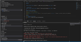

I have just started the NCS Fundamental Course and I am stuck on Exercise 2. There are two problems that I am facing.
1) I have an nrf9160dk board. so if I compile for the nrf9160dk_nrf52840 board, I get a compilation error. I wanted to build for nrf52840 and not nrf9160 but the simple blinky program gives the following error.
2) If I change the board, to Particle Xenon and connect using the debug-out port. I am not able to Flash or Flash & Erase the program. I got the following error.
Now I am able to run the program using Debug but the simple Flash/Flash and Erase don't work.
I realized that there are some features mismatched in the given videos and the actual extension of the VsCode. It looks different than it is shown in the video.
Thanks for helping out.
Waqas

  • hello Elfving,
    Thanks for replying.
    1) I know on the nrf9160dk board LEDs are not connected to nrf52840 and it required a Softswitch. but the generic example doesn't have support for that?
    2) you didn't understand the issue. If you read the error message in the screenshot it says
    Argument --snr is deprecated, use -i/--dev-id instead.
    so I can't program even the nrf9160 board. the arguments are tied to  Erase and flash buttons so technically using the extension on vscode I can't directly program any board. but if I press the debug button, I am able to program. so the only way to program a board is using debug mode.
    This isn't saying that there is anything wrong, it is just a warning informing you that the command being used for specifying the serial number is outdated (but you don't need to specify that anyway). I understand how this can be confusing, as you wouldn't expect to see any warnings. Our extention is continously being worked on, and you might see this warning removed in a later version. I acctually get the same warning myself, yet everything runs from my end.
