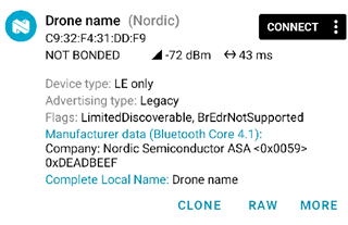

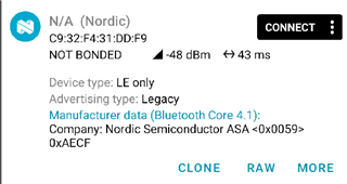

  • Are you sure it's not displayed? Note that the adv. is updated to *only* include the manufacturer field so you won't see the device name afterwards.
    Here is what I see after the adv. have been updated:
    And before:
  • Thanks much.. I think that is the problem I check with the client about it he has the Nrf52833DK.
    one more thing I asked, so we need to initialize the device name again in this function as we put in above in function advertisement_init();
    like this :
    Do you have any example of how to do this advertisement in a proper way? with the device name. That's very helpful for me.
    Thanks
  • No problem. Yes, if you want to continue including the device name in your adv., then just add this line to your update_function:

        new_advdata.p_manuf_specific_data = &manuf_data;
        new_advdata.name_type = BLE_ADVDATA_FULL_NAME; //Include full device name in advertising data.
