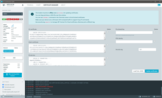

    I see that there is no data for tag 16842753.
    As I understand it, we do not have certificates for accessing the nRF cloud. How can we get them back?

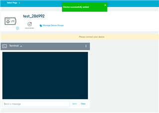

    How did you write:
    The first AT#XNRFCLOUD=1 command initiates the connection to the cloud. on the initial connection, the JITP step is performed and nRF Cloud immediately disconnects the device, hence the #XNRFCLOUD: 0,0 responses.
    After that, I try to add my user device to the nRF cloud using the user ID (not IMEI, used the device ID, the same one used when generating certificates) and any password as you said earlier:
    For you custom board you can choose a Device ID that fits your application along with a PIN/HWID of your choice.
    Any attempts to add a devay give an error code: Code 40412.
    Naturally, repeated execution of the AT#XNRFCLOUD=1 command does not give access to the cloud.
    What are we missing? Why we cannot registration the device in nRF Cloud? and continue to use AGPS?

    I've programmed the SLM application and tested generating the following certs
    Then using the certificate manager in LTE Link Monitor to provision to my nRF9160DK
    2022-04-07T09:52:58.347Z INFO Updating CA certificate...
    2022-04-07T09:52:58.348Z DEBUG modem >> AT%CMNG=0,321,0,"-----BEGIN CERTIFICATE-----
    2022-04-07T09:52:58.360Z DEBUG modem >> MIIDQTCCAimgAwIBAgITBmyfz5m/jAo54vB4ikPmljZbyjANBgkqhkiG9w0BAQsF
    2022-04-07T09:52:58.581Z DEBUG modem >> rqXRfboQnoZsG4q5WTP468SQvvG5
    2022-04-07T09:52:58.593Z DEBUG modem >> -----END CERTIFICATE-----"
    2022-04-07T09:52:59.989Z DEBUG modem << OK
    2022-04-07T09:52:59.990Z INFO Updating client certificate...
    2022-04-07T09:52:59.991Z DEBUG modem >> AT%CMNG=0,321,1,"-----BEGIN CERTIFICATE-----
    2022-04-07T09:53:00.003Z DEBUG modem >> MIICojCCAYoCCQCRSlfrvINUyjANBgkqhkiG9w0BAQsFADBwMQswCQYDVQQGEwJO
    2022-04-07T09:53:00.177Z DEBUG modem >> 3M3LgJOd
    2022-04-07T09:53:00.188Z DEBUG modem >> -----END CERTIFICATE-----
    2022-04-07T09:53:00.202Z DEBUG modem >> -----BEGIN CERTIFICATE-----
    2022-04-07T09:53:00.214Z DEBUG modem >> MIIDszCCApugAwIBAgIJAIt6VMjGN2CzMA0GCSqGSIb3DQEBCwUAMHAxCzAJBgNV
    2022-04-07T09:53:00.450Z DEBUG modem >> jzV+sF0OhtHgMgnAkUUU05UCqi8gWuC+qtimwx80X+ETCq4jpGqj
    2022-04-07T09:53:00.462Z DEBUG modem >> -----END CERTIFICATE-----"
    2022-04-07T09:53:00.514Z DEBUG modem << OK
    2022-04-07T09:53:00.516Z INFO Updating private key...
    2022-04-07T09:53:00.518Z DEBUG modem >> AT%CMNG=0,321,2,"-----BEGIN EC PARAMETERS-----
    2022-04-07T09:53:00.532Z DEBUG modem >> BggqhkjOPQMBBw==
    2022-04-07T09:53:00.544Z DEBUG modem >> -----END EC PARAMETERS-----
    2022-04-07T09:53:00.555Z DEBUG modem >> -----BEGIN EC PRIVATE KEY-----
    2022-04-07T09:53:00.567Z DEBUG modem >> MHcCAQEEIAQgeXklbT8V93LOekZgK+zuKxTEiw4IFSz8Yg2pPG1BoAoGCCqGSM49
    2022-04-07T09:53:00.579Z DEBUG modem >> AwEHoUQDQgAEVZ8c8YzWCw/MSi85fJhVCv8h3eRFX7f4+WYoTutXX9MRyksPP6HA
    2022-04-07T09:53:00.704Z DEBUG modem >> C/RWEoj4NeNK5JM7uEq3eRdVMDh1eRLSuA==
    2022-04-07T09:53:00.725Z DEBUG modem >> -----END EC PRIVATE KEY-----"
    2022-04-07T09:53:00.825Z DEBUG modem << OK
    2022-04-07T09:53:00.826Z INFO Certificate update completed
    Then I run the following:

    This time I went into nRF Cloud and added LTE device on sec tag 321
    I'm trying to follow your instructions, but it doesn't work so far.
