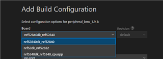

  • Hey. I cannot see any BLE peripheral examples that compile onto the nrf5340dk_nrf5340_cpunet. For example, if I try and build "peripheral_bms" on v1.9.1, then the cpunet core doesn't even appear as a compatible board:

    It's not officially tested to be built for that, but you can still select the net core by selecting e.g. Nordic boards.
