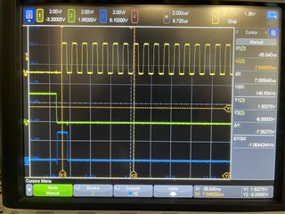

    Sorry for being unclear. After some further debugging I can say that my main problem is:
    When I ask my spi slave to send the following 65 byte packet:
    static uint8_t       m_tx_buf[] = {0,0,0,0,0,0,0,0,0,0,0,0,0,0,0,0,0,0,0,0,
                                       0,0,0,2,2};
    My spi master will receive:
    {8,0,0,0,0,0,0,0,0,0,0,0,0,0,0,0,0,0,0,0,
     0,0,0,2,2};
    With the only difference is that the 0 index's MSB is 1. I've tried out a number of different numbers in the first byte (m_tx_buf[0]) and it seems like the first 4 bits of my SPI packet always end up being something weird. E.g. if I want to send the decimal number 80 then I receive 0xd0 (instead of 0x50). If I try to send decimal127 then the master receives 0xff (instead of 0x0f). The bottom line is some values seem to confuse the SPI driver. Am I not setting m_tx_buf properly?
    For the send decimal 0 and receive 0x80 case:
    I probed the SCLK, CS, and MISO lines with an oscilloscope and observed that CS and SCLK behave properly (65 bytes worth of data are indeed shifted out over MISO). The odd thing is that the first bit sent over MISO is 1! Regardless of what I try to send. This means the master is reading everything in properly and the issue seems to be with the spi slave...
    To make things weirder I have the spi slave print out what m_tx_buf[0] is with NRF_LOG_INFO before and after each spi transaction and it is always 0 (as it should be) but again - the received first byte is 8 (which is 1000000 - meaning the msb is erroneously 1).
    To belabor the point some more here is a screenshot of the oscilloscope with the following signals (SCLK, CS, and MISO):
    That first bit on MISO should be 0!!

  • I can see there is no delay between CS going low and first SCK. Can you on the master SPI add a 10us delay between the two as earlier suggested, I want to see how that affect what you are seeing.
    Kenneth
  • Hi Kenneth,
    I'm trying this out but it doesn't seem to be changing the time between CS going low and SCK's first clock cycle. I added nrf_delay.h and the delay right before spim_xfer() (my nrfx_spim_xfer function is copied below).

    Am I doing something wrong? I tried 10us and 100us of delay and couldn't observe any delay over the oscope. Is there another way to add this delay?
  • Odd that the delay did not have any effect, I suggest to continue debugging to see if you have any new observations. Maybe the delay is somehow optimized away, though you can set a breakpoint there just to confirm you are hitting the line of code. Do you see the same issues when using the nrf5 sdk examples as-is?
    Kenneth
  • I put a breakpoint at the delay and it is getting hit but I still can't see the delay over an oscilloscope which is weird.
    What's weirder is that the issue exists with the bare examples too!! I've attached zips of my spis and nrfx_spim firmwares below.  The only changes remaining are a slightly updated test string and the disabling of DCX.
    Rather than sending the expected "nordic123456", the slave device sends out ".ordic123456" where the period is NRF_LOG_HEXDUMP_INFO's attempt at interpreting 'FF' or 'CE'. Am I not supposed to use the spis example firmware with the nrfx_spim? Surely someone must have run into this problem before.
    Also at this point I've tried out multiple physical dev kits to make sure there wasn't some hardware/chip specific/lemon issue.
