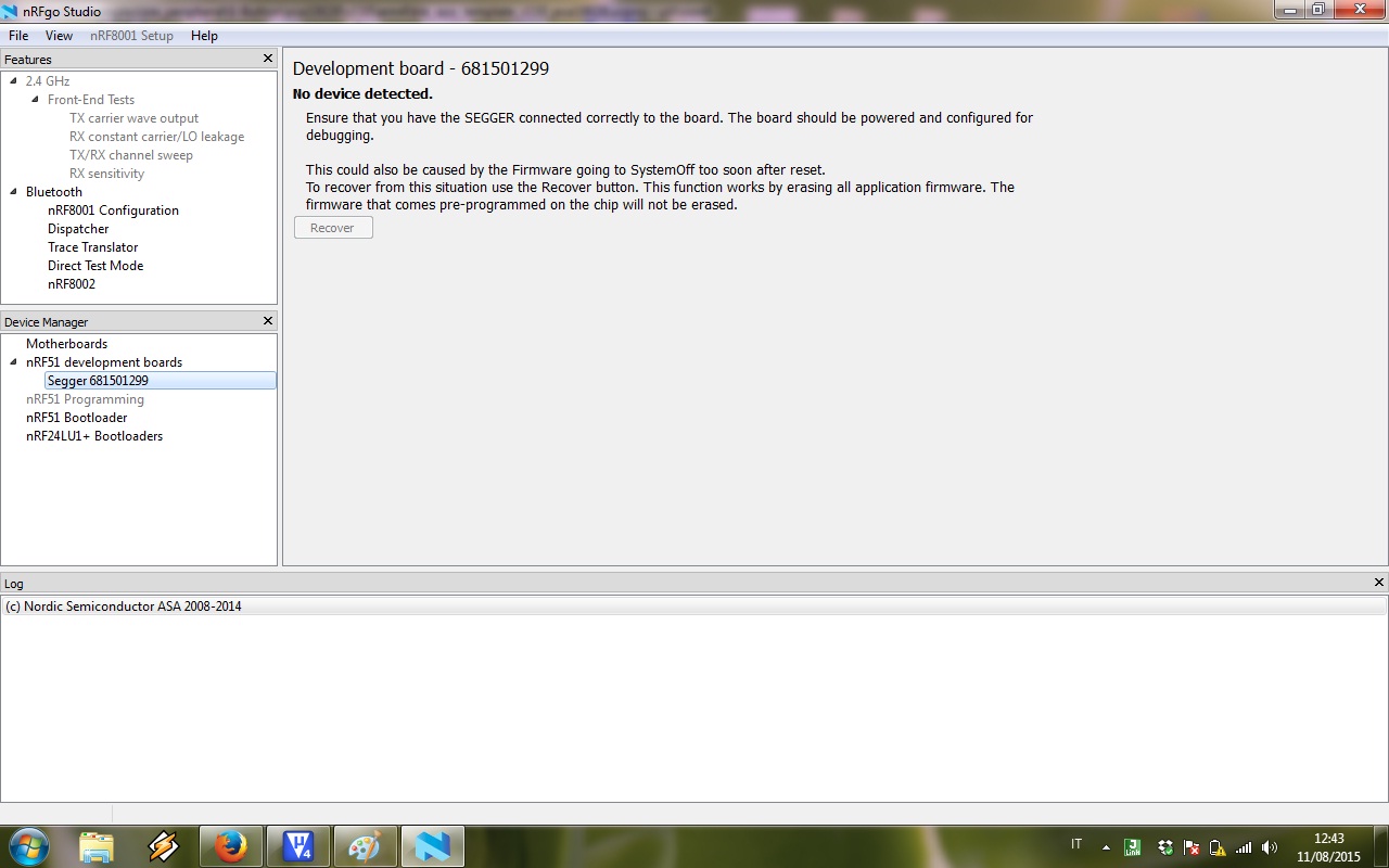

I've a problem using pstorage: after I execute a pstorage_clear, my ic (i have the pca10028 board) go crazy, the application I've write stop execute and I can't flash download again from Keil. So I tried to reflash it by nRFgo but when I select the Segger it give me the attached screen. After much attempts it restart to work, but I have to flash an hex without pstorage command.

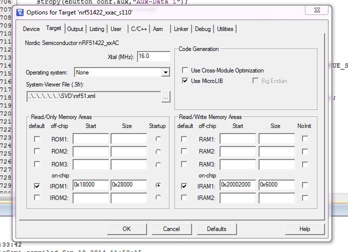

I've started my application by ble_peripheral template without using the scheduler, I'm using the S110 with the attached screen configuration. I attach the code also.
I've checked the memory by debugger, and I've saw that the code start from 0 (softdevices) to 18000 and after there's my application code, all correct, the pstorage block handle give me a value of 0x3F400 that is 3 k under the flash end address (0x40000) cause I allocate 2 pstorage pages of 1024 plus the pstorage swap page.

About the issue of the bad flash state after this operation (the Keil can't re download the firmware and nRFstudio can't get the device connected), I try to erase 63 bytes instead 64: with 63 the application always doesn't work but the Keil and nRFstudio problem doesn't happen (I don't undestand why.....).

    Firstly I recommend you to use the error codes in the SDK and SoftDevice, for example instead of
    pstorage_clear(&flash_block_0_handle,60);
    do
    uint32_t err_code;
    err_code = pstorage_clear(&flash_block_0_handle,60);
    Then you can check the error code using the debugger (if you have turned of optimizations, Target for Options->C/C++->Optimization->Level 0) 0x00000000 is NRF_SUCCESS, if you get something else you can use the error code to give you a pointer to what is wrong. Set a breakpoint on APP_ERROR_CHECK().
    With the above code you will get NRF_ERROR_INVALID_PARAM, and no clear will be performed. This is because the size input must be a multiple of block size. Your block size is 64, so you can use 64 (or 0). Anything else will return an error. This is stated in pstorage.h above pstorage_clear().
    If I set the size to 64 your application seems to be working fine.
