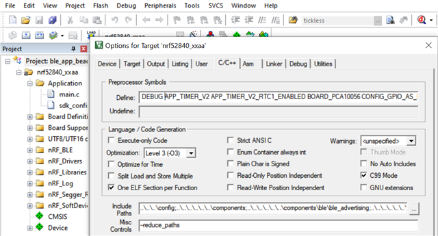

    Could you also confirm whether or not you have DEBUG defined in your preprocessor defines, like shown in the included image?
    This will make your logger output a detailed error message whenever a non-NRF_SUCCESS error codes is passed to an APP_ERROR_CHECK.
