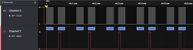

Reading CHIP_ID repeatedly (peripheral correctly supplies the value 0x60):
However, the nRF52 incorrectly gets the value 0x00.
<info> app: BME280 Chip ID: 0

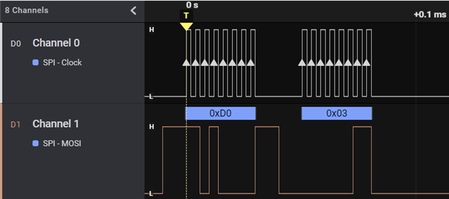

    I did upload the logic analyzer trace, it's in the post. I don't have a trace with all of the signals together, but that one shows CLK & MISO. Here is one more that shows CLK & MOSI for the same command.

    1. The useful Rx data from the BME280 starts with the 2nd byte, not the first; the BME280 doesn't know what to send until it receives the first byte, so the id appears in the 2nd received byte. The first byte received and reported  in this case is 0x00, the 2nd byte 0x60. (Ignore this comment if you are already reporting the 2nd Rx byte)
    2. The logic probe is showing ideal signals which don't match actual signals in most cases; improve performance by setting all outputs (SCK, MOSI, CS) (in CNF) to H0H1 drive strength immediately after initializing the SPI peripheral. When all is working well you can experiment by reducing drive strength but there is no real advantage to doing that.
