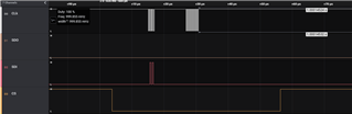

I am trying to develop a driver for the temperature ADC controller ADS124S08 https://www.ti.com/product/ADS124S08
I have modified the EVM to work with an external processor https://www.ti.com/tool/ADS124S08EVM
I created a simple driver that just reads the data rate register every second, the default value should be 0x14 but instead it is reading 0 continuously indicating it is unable to read the register.
As shown in the logic analyzer plot below,  the wave form is also quite far off the expected wave form from the datasheet:
Based off the above plot, it doesnt appear that the spi_transceive function is getting a response from the IC.
Below is a simplified version of the driver code.

  • Could I get a logic trace focused on just the command, it's a little hard to see the command is relation to the clock pulses.
    But from what I can see the command isn't being sent correctly, and maybe that the hold time on the command bits is too long.
    I also am not sure about the nrf_gpio_pin_clear() and nrf_gpio_pin_set() calls in ads124s08_reg_read() in ads124s08_spi.c.
    I haven't seen that done before. The transceive function should be able to handle the CS itself.
    Is there a reason you added those?
