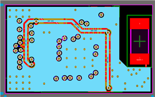

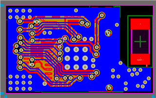

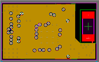

请问,NRF52833 QDAA,使用VDDH供电,开启DCDC,传输正常,但是接收数据有很大延迟,超过500ms,同样的程序,刷入QIAA模块没有问题,但是 QDAA 存在问题,电路图使用数据表中的示例电路制造。希望有人可以指导和帮助,问题到底出在哪里。

你需要咨询一下模组厂商,他们是不是定义了不一样的pin,nRF52833-QDAA与nRF52833-QIAA的IO是不一样的,可能会有速率的差异,排除之后可能是硬件的问题,注意一下是否虚焊或者外部晶振
I soldered 2 pieces of PCB, both have the same problem, the IO used has also changed, they are all working, the problem is just random delays (greater than 500ms) in receiving data, I can't find the problem.
Sending data is all fine, only receiving data with random high latency.
