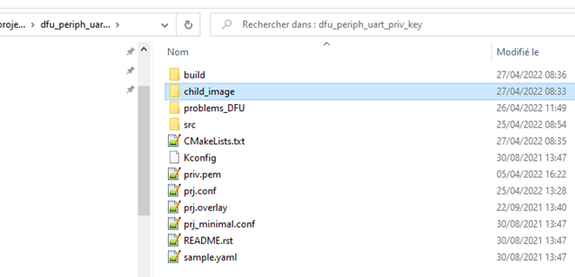

MCUBoot private key on nrf5340dk
I work with win10 laptop, Toolchain  nrf Connect SDK 1.6.1 on a nrf5340dk. I use peripheral_uart sample.
I follow the guide:
https://devzone.nordicsemi.com/guides/nrf-connect-sdk-guides/b/software/posts/ncs-dfu
It's work well.

  • Hi Øivind,
    I find the problem, now it's working.
    I change the place were I have put ''mcuboot.conf", I put inside a folder called child_image and I deleate:
    if (EXISTS "${CMAKE_CURRENT_SOURCE_DIR}/mcuboot.conf")
        list(APPEND mcuboot_OVERLAY_CONFIG
    endif()
    from CmakeLists.txt file.
    Thanks you for your help.
    Best Regards,
    Rob
  • Ah, I apologize, I saw that it was in an unusual place, but I just assumed it was allowed on the older version of the SDK.
    Great job figuring it out!
