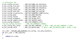

  I am using SGTL5000 CODEC to playback the LINEIN and I am using the SGTL5000 driver from this link
I am using this I2S configuration

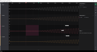

For I2S Loopback code itself the latency is around 18ms,
Can you guide me on how can i reduce the latency down to 5ms
    It's an unofficial example, and I don't have the HW to test here. The only thing I can see that could perhaps affect this is what AUDIO_FRAME_WORDS is set to, and what frequency you run the I2S at.
  • Hi Sigurd,
    Here is the configure of I2S
     // Initialize I2S
        m_i2s_config.sck_pin      = DRV_SGTL5000_I2S_PIN_BCLK;
        m_i2s_config.lrck_pin     = DRV_SGTL5000_I2S_PIN_LRCLK;
        m_i2s_config.mck_pin      = DRV_SGTL5000_I2S_PIN_MCLK;
        m_i2s_config.sdout_pin    = DRV_SGTL5000_I2S_PIN_TX;
        m_i2s_config.sdin_pin     = DRV_SGTL5000_I2S_PIN_RX;
        m_i2s_config.irq_priority = DRV_SGTL5000_I2S_IRQPriority;
        m_i2s_config.mode         = NRF_I2S_MODE_MASTER;
        m_i2s_config.format       = NRF_I2S_FORMAT_I2S;
        m_i2s_config.alignment    = NRF_I2S_ALIGN_LEFT;
        m_i2s_config.sample_width = NRF_I2S_SWIDTH_16BIT;
        m_i2s_config.channels     = NRF_I2S_CHANNELS_LEFT;
        m_i2s_config.mck_setup    = NRF_I2S_MCK_32MDIV8;
        m_i2s_config.ratio        = NRF_I2S_RATIO_96X;
    and the Frame size is
    #define AUDIO_FRAME_WORDS                   320
    #define AUDIO_SAMPLE_LEN                  AUDIO_FRAME_WORDS/2
    #define I2S_BUFFER_SIZE_WORDS               AUDIO_FRAME_WORDS * 2   // Double buffered - I2S lib will switch between using first and second half
    static uint32_t  m_i2s_tx_buffer[I2S_BUFFER_SIZE_WORDS];
    static uint32_t  m_i2s_rx_buffer[I2S_BUFFER_SIZE_WORDS];

    I have check that we are initializing the I2S with 160 words.
