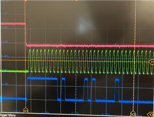

I'm using two dev kits to test out some SPI firmware before I deploy it to our custom boards and I've been running into a weird issue where my SPIS sends out corrupted data. The data corruption exists at an SCK of 1MHz and it gets worse when I go up to 4MHz and even worse at 8MHz.
An example of the data corruption is as follows:
I fill up the SPIS's m_tx_buf with: 0x41410000000000000000000000000000000000000000000000000000000000000000000000000000000000000000000000000000000000000000000000000202
but when a spi transaction is triggered, the SPI peripheral shifts out the following over the MISO line:
0xff41410000000000000000000000000000000000000000000000000000000000000000000000000000000000000000000000000000000000000000000000000002
I've probed the MISO line with an oscope and here's a screenshot of the first couple bytes. In it you can see that the spis actually 'adds' ff to the beginning.
sometimes the data is corrupted differently and I will receive something like:
0xffa0a08000000000000000000000000000000000000000000000000000000000000000000000000000000000000000000000000000000000000000000000000001 which has 9 bits of 1 at the front (right?).
I've tried printing out these bytes in debug mode (using NRF_LOG_INFO()) and those report the correct bytes back regardless of when I query the buffer. My spis code is built off the example in SDK 17.1 and it's really really quite similar - is there some limitation for SPI packets >= 65 bytes? Here is a copy of my code as reference:

    What is your SPI master? Can you please try to set the Chip Select pin low a little bit before you start the clock from the central and see whether the behavior changes?

    I have not had the chance to test this myself yet. And I am sorry for the short reply, but we are very short staffed here in Norway due to Easter Holidays this week (and Monday next week). I am sorry for the inconvenience regarding the delayed response.
    As far as I can tell, you don't set the NRFX_SPIM_SS_PIN as an output pin. Try adding this to your code, before your main-loop.

  • No worries! I tried this out but kept hitting hard faults whenever the debugger would hit the nrf_drv_gpiote_init function. I was having a little trouble decoding what the error code meant - how would you recommend looking up the specific error meaning?
    Regardless, however, is this recommended for all SPIS use cases? Since I'm seeing this with the base example code maybe something else is wrong.

  • Hello Ryan,
    You said that you are using the default nrfx_spim example. What example do you mean exactly?
    I tested these two, and connected the DKs using some PCB wires, and this is my outcome:
    SDK17.1.0\examples\peripheral\spi
    SDK17.1.0\examplws\peripheral\spis
    The master (spi example) is to the left, and the spis example is to the right. I don't see any issues using these unmodified examples, at least. Did you test them? I see that in your original question, your message is larger, and not from the examples. Is there a way for me to reproduce this using two nrf52840 DKs without any additional hardware? If so, can you zip the two project folders (please specify what SDK version you are using), and I can give it a go.
    Edvin

  • Hello Ryan,
    I see. I actually wasn't aware there was an example called nrfx_spim. I guess I just used the spi example (which also uses the nrfx driver), and didn't notice that it was introduced (whenever that was).
    I haven't looked into the differences between nrfx_spim and spi, but both of them uses nrfx_spim_init(), so I guess they are using the same driver, but a bit differently.
    I tested the unmodified nrfx_spim with the spis example, and I saw, like you saw, that the first byte was corrupted. I tried adding a delay before pulling the CS/SS pin low in the nrfx_spim's main.c, and then I got the first byte to show correctly again.
    Can you try something like this:

    Edvin
  • Hi Edvin,
    That did the trick! I must have messed up the init code when I tried toggling the ss earlier - removing my changes and adding yours worked like a charm!!
    Thank you so much for your help, I really really appreciate it.
    Kindest regards,
    Ryan
