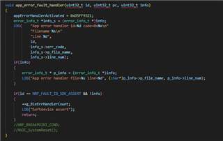

Any idea what 0x62D means? I am sure I don't have so many lines of code as reported.
I was trying to do a breakpoint and examine the call stack but for some strange reason, I can't set a breakpoint in main.c where the app_error_fault_handler() was defined, reason given by VS code "No source file named main.c". I am able to set and break at other breakpoints in other source modules.

    This is what the default app_error_fault_handler looks like in the nRF5 SDK v15,

    NRF_FAULT_ID_SD_ASSERT is ID 1, so looks like you are getting a SoftDevice assert.
    1) Could you print the pc value you get in app_error_fault_handler() ?
    2) What version of SD S140 are you using?

    While waiting, do you know why the filename and line number are "scrambled" in the printout and also why I cannot set breakpoint in main.c
    I don't think these fields are valid/populated when it comes to SD asserts.

  • Hi Sigurd,
    I've got the value of PC when exception occurred.
    PC=0x17660
