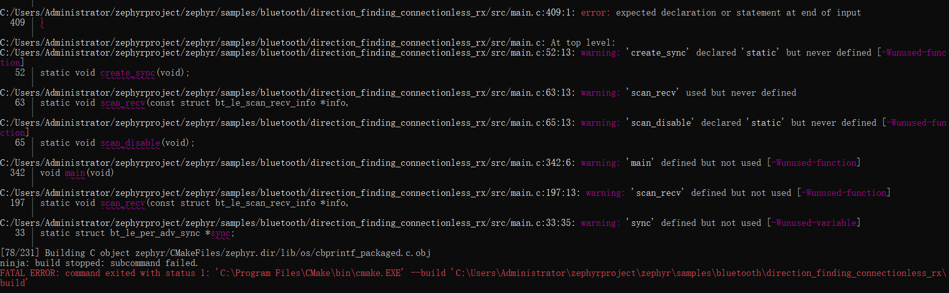

In Rx,add iq print in main.c,building project has a error,but in 52833,it succefully.what is this problem?
when i make Rx  output  succefully.i add some  configuration in main.c.i can print iq data.there is link that make me to learn to print iq data.

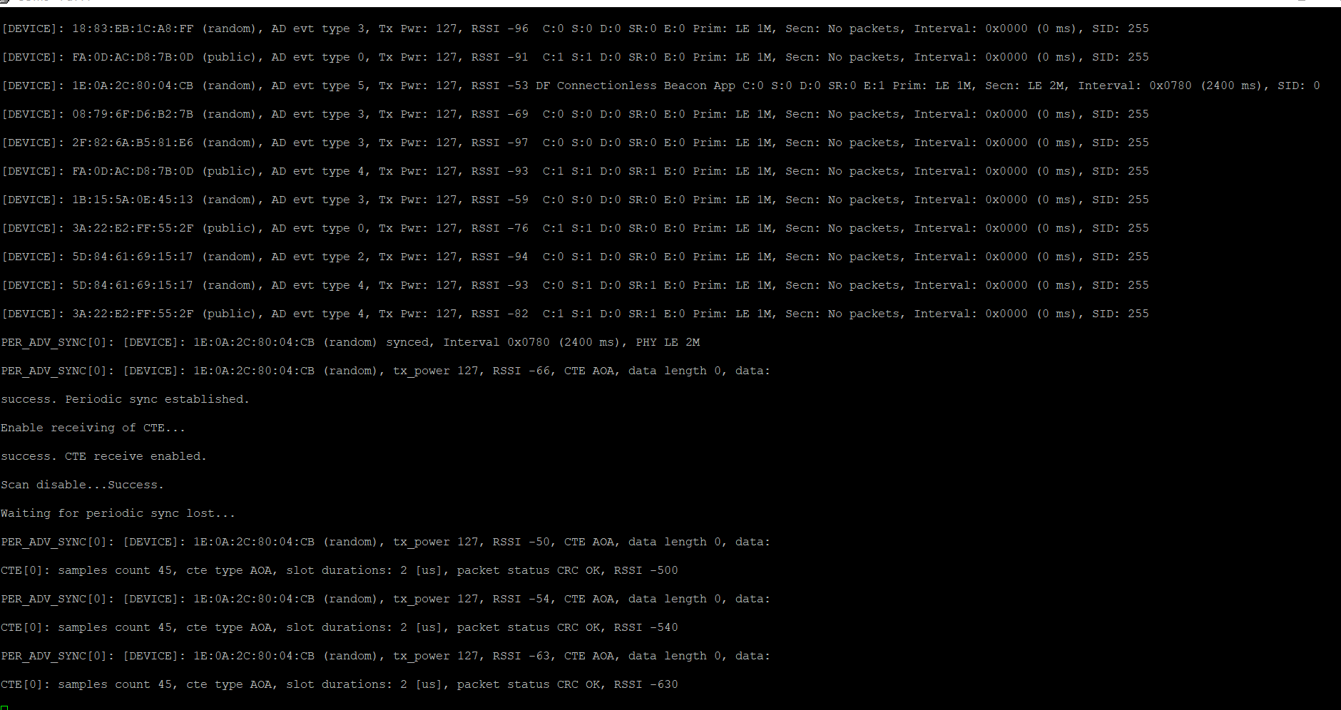

in nrf5340 dk,i also get full output.i want to add iq sample.so i add configuration sa nrf52\.
this picture is output without iq sample.
but when i do the same things as 52,it has a error.build fail.
where is this problem?please help me.

  • ok,i find my configuration has a error.i modify it ,them flash it to boards.there are iq samples in Putty.this i sabout nrf 54340dk in Rx.you cna ge t more infomation
