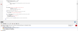

How can I detect or using a flag to indicatate that RX buffer was full ?
I follow this thread of Edvin thread
But i got this problem
Thank you !
    My problem was solved
    There is some difference from Edvin thread I follow
    in main.c
    if (p_evt->data.rxtx.src == 0)
    NRF_LOG_INFO("triggered by full buffer");
    } else if (p_evt->data.rxtx.src == 1)
    NRF_LOG_INFO("Triggered by timeout");
