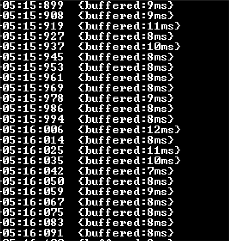

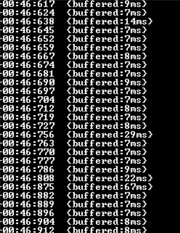

    for the measurement In the FW side I'm using UART to see successfully sd_ble_gatts_hvx  buffering time also can see BLE_GATTS_EVT_HVN_TX_COMPLETE time and distance between 2 subsequent events , The log shows almost each 7.5ms one packet is accepted as we can see in the logs here.
    In the application side I measure received RX bytes and it is 220 kb/s. It seems windows always receive packets each 7.5ms and it doesn't matter what is connection interval time!. is there any solution for that or is there anyone could achieve more than one packet each 7.5ms (more than 260kb) with windows?
    and why even when i don't send data, connecting second device reduces first connected device speed!?
    thanks!

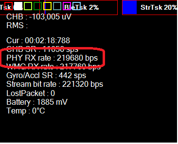

    Maximum rate is in the PHY RX rate field
    this log above, is for 7.5ms connection interval with conn_evt_ext enabled
    this log above, is for 23.75ms connection interval with conn_evt_ext enabled

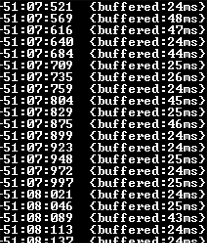

    this log above, is for 23.75ms connection interval with conn_evt_ext disabled, this one shows if we disable multipacket each interval only receives one packet and if it is enabled windows acts like 7.5ms connection interval.
