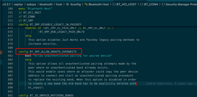

    However, occassionally the pairing fails with an error code "Failed to set security level".  The peripheral has bond information stored in NV memory, but the Central doesn't.

  • Thanks for the update. Default behaviour is that the peripheral will reject a pairing request from an already bonded peer device. You can change this by enabling the CONFIG_SMP_ALLOW_OVERWRITE setting, but as indicated in the help text, it has some security implications that should be considered.
  • I set the security level in the Central instead of in the Peripheral when the connection is established.  Function bt_conn_set_security() is called from the connected() callback via a kwork item.
    I've been testing this with both devices not bonded to anything.  I erase the bond information each time before testing.
    The two devices pair and then bond reliably when they connect.
