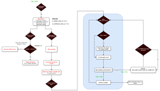

I have developed an app to read data from some sensors and notify the central with a frequency of 100Hz. It seems to work but I would like to share my approach and let me know of any improvements
I have two application timers. The first one expires every 200us and sample some pressure sensors and the second expires every every 10ms. The 10ms timer calls the read_sensors(), where I sample the IMU (IMU_read()), increment a packet counter (packet_increment()), buffer the sensors data (my_sensors_buffer()) and attempt to transmit (data_tx())

When I call the data_tx() I try to transmit all the queued data while (err_code == NRF_SUCCESS)
The ble_cus_custom_value_update() gives a call to sd_ble_gatts_hvx()

In case of NRF_ERROR_RESOURCES I wait for the BLE_GATTS_EVT_HVN_TX_COMPLETE event and call again the data_tx()

This is the block diagram. A bit complicated :/
