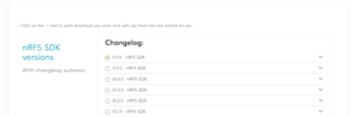

    regard sdk in the website only version 17 is available for download

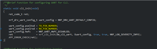

  • In the nRF5 SDK v17.1.0 that you presume you have downloaded, you will find the pin number as defined like the picture above.
    You can change the "TX_PIN_NUMBER" and "RX_PIN_NUMBER" to the pins you need to use in your layout. You only need to edit the two instances to P0.06 and P0.08

  • Well this is not good enough as this is Only UART pins,I got inputs that pins are defined in h file
    and also need to define ALL the 4 pins required not only rx tx

    #define RX_PIN_NUMBER 31 //8
    #define TX_PIN_NUMBER 2 //6
    #define CTS_PIN_NUMBER 3 //7
    #define RTS_PIN_NUMBER 5
    #define HWFC true

  • PCA10040.h i changes as follows, currently still having issues ...
