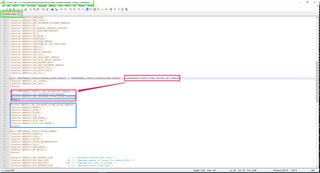

I am trying to integrate the Google IoT Cloud example into my CoAP Server. The example is using Secure API to esablish COAPS.
I have enabled
CONFIG_OPENTHREAD_COAP=y
CONFIG_OPENTHREAD_COAPS=y
CONFIG_OPENTHREAD_JOINER=y
#CONFIG_NORDIC_SECURITY_BACKEND=y
CONFIG_BASE64=y
CONFIG_MBEDTLS_BUILTIN=y
CONFIG_OPENTHREAD_SLAAC=y
in my prj.conf
There seems to be a confusion about where to find the mbedtls_base64_encode() function
openthread/src/core/meshcop/dtls.cpp
In file included from C:/nordic_sdk/v1.9.1/modules/lib/openthread/src/core/common/code_utils.hpp:41,
from C:/nordic_sdk/v1.9.1/modules/lib/openthread/src/core/common/message.hpp:45,
from C:/nordic_sdk/v1.9.1/modules/lib/openthread/src/core/meshcop/dtls.hpp:55,
from C:/nordic_sdk/v1.9.1/modules/lib/openthread/src/core/meshcop/dtls.cpp:34:
C:/nordic_sdk/v1.9.1/modules/lib/openthread/src/core/meshcop/dtls.cpp: In member function 'ot::Error ot::MeshCoP::Dtls::GetPeerCertificateBase64(unsigned char*, size_t*, size_t)':
C:/nordic_sdk/v1.9.1/modules/lib/openthread/src/core/meshcop/dtls.cpp:528:9: error: 'mbedtls_base64_encode' was not declared in this scope
528 | mbedtls_base64_encode(
C:/nordic_sdk/v1.9.1/modules/lib/openthread/src/core/common/arg_macros.hpp:77:40: note: in definition of macro '_OT_GET_FIRST_ARG'
77 | #define _OT_GET_FIRST_ARG(aFirst, ...) aFirst
C:/nordic_sdk/v1.9.1/modules/lib/openthread/src/core/common/code_utils.hpp:124:15: note: in expansion of macro 'OT_FIRST_ARG'
124 | if (!(OT_FIRST_ARG(__VA_ARGS__))) \
C:/nordic_sdk/v1.9.1/modules/lib/openthread/src/core/meshcop/dtls.cpp:527:5: note: in expansion of macro 'VerifyOrExit'
527 | VerifyOrExit(
[165/833] Building CXX object modules/openthread/build/src/core/CMakeFiles/openthread-ftd.dir/meshcop/meshcop_leader.cpp.obj
Even though the CONFIG_BASE64=y should enable the MBEDTLS_BASE64_C the package does not get linked to.
  • It seems that only the main SECURE_API needs to be enabled in Kconfig, to trickle down the other define option.
    I tried to build the coap client sample from NCS\nrf\samples\openthread\coap_client with the configs that you listed, but I didn't get any errors. Perhaps there is one of the configs in that sample that triggers the OPENTHREAD_CONFIG_COAP_SECURE_API_ENABLE. I didn't look too deep into it.
    What sample are you trying to build?
