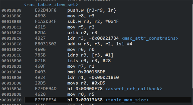

802.15.4 precompiled library limited
I based my project on the secure wireless uart example in the nrf5 SDK and linked to the precompiled gcc library 802_15_4_lib_gcc.a
I then tried to add multiple entries to the MAC tables in security.c using mac_table_item_set(). All goes well for the first 2 entries, but the 3rd generates a hard fault as the max table limit is hit (table_max_size).
.text.table_max_size  0x0000000000013a58 0x34 ../../../nRF5_SDK/components/802_15_4/secure/802_15_4_lib_gcc.a(mac_mlme_pib_table.o)
According to the ,map file, this is part of the precompiled library, so I am unable to change it. Is there a way around this limit? How to I recompile this library?

    What is the error code returned by mac_table_item_set()? This will tell you whether the issue is because the table index is out of range or because there is not enough dynamic memory to put the item into the security table.
    What are you sending in as parameters of mac_table_item_set()? The id parameter is used to let mac_table_item_set() know the size of the new table item based on what type of table it is, such as MAC_KEY_TABLE, MAC_DEVICE_TABLE etc. If the table index parameter, idx, is larger than the size of the table item you will get an error that the table index is out of range, MAC_INVALID_INDEX. You can find the table sizes of the different types of tables in 802_15_4_config.h, such as CONFIG_MAC_DEVICE_TABLE_SIZE for MAC_DEVICE_TABLE.
    Marte
  • Hi Marte,
    For the first 2 calls, mac_table_item_set() returns MAC_SUCCESS. For the third call, it does not return – it generates a hard fault.

  • Hi Marte,
    All 3 elements are identical in size, I just changed the index. I must be doing something wrong. Could you please post the snippet of your test code that worked? I might help me spot where I am going wrong. I suspect one of my items should be declared as an array, but as I can't see what the library functions are doing, I am not sure what it is expecting.
    Allan
  • Hi Marte,
    I don't know if it all works yet, but I don't get the hard fault anymore. When I converted the function to be index based, I missed one instance.

  • Hi Marte
    Sadly it did not work. The first device in the table was able to communicate as normal, but the second could only receive packets. Packets sent from this device were received, but failed to be decoded and returned the following error code:
    MAC_SECURITY_ERROR = 0xE4, /* 228 */ /**< Cryptographic processing of the
    received secured frame failed. */
    I have just got it working and have all 3 devices communicating. They key was that if you have more than 1 device in the list, you have to set :key_device_descr.unique_device = false;
