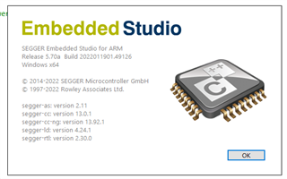

Would you teach me how to edit SES(Nordic version) on compile optimization level for nRF5_SDK_17.0.2_d674dde ?
I use SES 5.70a. I cannot found it in project options.

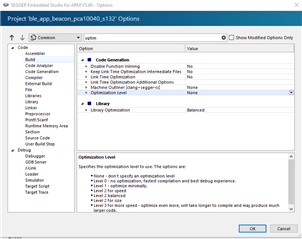

In SEGGER Embedded Studios for instance, there is an Optimization Level in the project options that lets you set the optimization level to I.E. Optimize for Size.
If you press Options... in the window you have there, you should get to the project options, then set the build configuration to Common andfind Optimization level under Code Generation.
Simon
