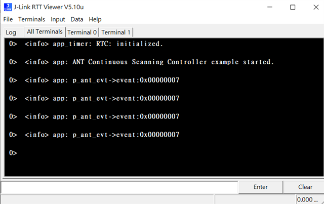

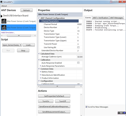

So,I first practice with example ant_continuous_scanning_controller(SDK 17.0.2, SoftDevice S212 ). Test with SimulANT+ (Version 2.3.0.0). Open 2 BPWR devices at the same time, But it can't find any device normally.
bpwr  device:
I press button ,It always shows up p_ant_evt->event: 0x00000007(EVENT_CHANNEL_CLOSED).
I try to change the setting of sdk_config.h, But it still doesn't work.

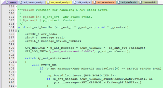

  • Thanks for  your  reply! I  add ANT_PLUS_NETWORK_KEY to  code  as you  said.
    void ant_evt_handler(ant_evt_t * p_ant_evt, void * p_context)
        uint32_t err_code;
        uint8_t  message_rssi;
        uint16_t message_device_number;
        ANT_MESSAGE * p_ant_message = (ANT_MESSAGE *) &p_ant_evt->message;
    		NRF_LOG_INFO("p_ant_evt->event:0x%08X", p_ant_evt->event);
        switch (p_ant_evt->event)
            case EVENT_RX:
                if (p_ant_message->ANT_MESSAGE_aucPayload[0] == DEVICE_STATUS_PAGE)
                    bsp_board_led_invert(BSP_BOARD_LED_1);
                    if (p_ant_message->ANT_MESSAGE_stExtMesgBF.bANTDeviceID &&
                        p_ant_message->ANT_MESSAGE_stExtMesgBF.bANTRssi)
                        message_device_number =
                            (uint16_t)(p_ant_message->ANT_MESSAGE_aucExtData[0] |
                                       ((uint16_t)p_ant_message->ANT_MESSAGE_aucExtData[1] << 8));
                        message_rssi = p_ant_message->ANT_MESSAGE_aucExtData[5];
                        node_to_list_add(message_device_number, message_rssi);
            case EVENT_TRANSFER_TX_COMPLETED:
                bsp_board_led_off(BSP_BOARD_LED_0);
                bsp_board_led_off(BSP_BOARD_LED_1);
                err_code = sd_ant_channel_close(ANT_SCAN_CHANNEL_NUMBER);
            case EVENT_TRANSFER_TX_FAILED:
                if (m_retries > 0)
                    command_send();
                    m_retries--;
                else
            default:
                break; // No implementation needed
    Now it can receive EVENT_RX(p_ant_evt->event = 0x00000080),but it can't find
    "p_ant_message->ANT_MESSAGE_aucPayload[0] == DEVICE_STATUS_PAGE ", Check the log of SimulANT+,It doesn't seem  transmit DEVICE_STATUS_PAGE, How can  I solve  this problem?
