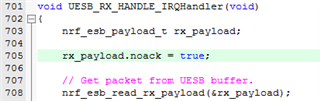

Hello Nordic Engineer,
I'm a beginner
In this GitHub
If I add code after 473 lines
rx_payload.noack = true
what will the final result be?
Thanks

  • eric_cheng said:
    RX can choose to turn off ack (do not send response to TX)
    This is not possible, it's only the TX that can control whether it want an ACK or not.
    eric_cheng said:
    TX can also choose to turn off ack (no response is received)
    Correct.
  • Thank you,
    TX can close or open ack, I understand this
    but for RX
    《rx_payload.noack = true;》What does this code do?
  • Calling rx_payload.noack in the callback irq handler will have no effect.
    If you don't want to receive an ack, then set this flag to true before calling nrf_esb_write_payload().
