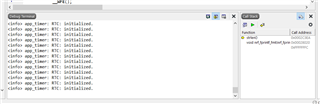

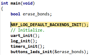

Problem when combining SPI and UART
I tried to combine the spi and ble_app_uart example. But I got this problem, and the program was stuck in this loop.
Here is what I did:
I am using the 17.1.0 sdk on nRF52832. I copy the code from the spi example and paste them in the ble_app_uart example. Then I checked the spi_config.h of the spi example and changed the configurations in the uart example(enabled SPI etc.). Then I added those .c files to nRF_Drivers library. And then I build it and run it.

    bool erase_bonds;
    // Initialize.
    uart_init();
    log_init();
    timers_init();
    power_management_init();
    ble_stack_init();
    gap_params_init();
    gatt_init();
    services_init();
    advertising_init();
    conn_params_init();

What was wrong here? How can I debug it? What is the routine to combine two functions?
Thanks in advance!
