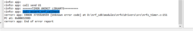

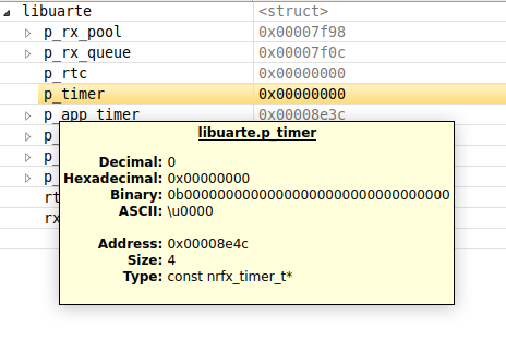

Init - Uninit libuarte problem in (ble_app_uart + libuarte + app_timer)
Hi, I'm developing an application which is merging from (ble_app_uart + libuarte + app_timer + pwm).
Here is my main.c
Now I'm developing an feature that using timer ((app_timer) for low power consumption than timer). And every 10s, libuarte will be uninit to save energy.
I can run the app timer but when I uncomment lines from 822 to 825 => my debug terminal got this problem

Hope your soon reply !
    The assert is raised because libuarte uninit is trying to disable a timer instance that has not been initialized, but I did not manage to replicate this with NRF_LIBUARTE_ASYNC_DEFINE() macros you posted here.
    Please check if the libuarte-p_timer and libuarte2->p_timer values are indeed != NULL before calling the uninit function.
    Vidar
