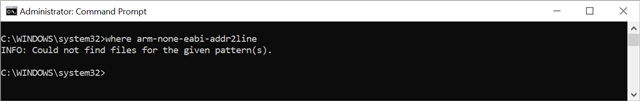

    If not, lets check out if the error you've pasted may help us. Could you open a command line window and write the following
    1) "where arm-none-eabi-addr2line"
    This should return something like
    C:\Program Files (x86)\GNU Tools ARM Embedded\4.9 2015q3\bin\arm-none-eabi-addr2line.exe
    If it does not return something like this, then we can't do the next steps.
    2) We now want to know what causes the error you've pasted. Write now:
    arm-none-eabi-addr2line -e <path to _build\zephyr\zephyr.elf> <0xaddr>
    where you replace "<path to build>" with your path and <0xaddr> with the R15/pc and R14/lr adress
    "arm-none-eabi-addr2line -e <path to _build\zephyr\zephyr.elf> <0x0001e533>" for r15/pc
    and
    "arm-none-eabi-addr2line -e <path to _build\zephyr\zephyr.elf> <0x0001e820>" for r14/lr
    This should (hopefully) return a function or variable that could point to why the cpu has crashed.
    Let me know about the progress.
    Andreas
  • Thanks for reply, Andreas
    here is what I did, and cannot go any further - did I misunderstand you?
    Ping
    You did it correct. This just means that gnuarmemb is not added to the your system variables, which we need to run the two other lines. If we need to/or you want to try this yourself while we look on the next possible solution, you could perform this step in the manual installation guide. It should allow you to run the two missing lines lines in the prior suggestion.
