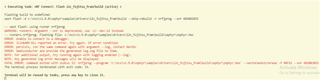

Unable to flash nRF52840dk using west flash
Hi there,
A couple of weeks ago, I'm facing the issue that my nRF52840DK board is not visible and led5 is flashing rapidly. I reflashed the bootloader, j-link-ob-sam3u128-v2-nordicsemi-170724, on the board by following the instruction here https://devzone.nordicsemi.com/f/nordic-q-a/8144/i-can-t-update-the-j-link-ob-firmware-nrf51-dk
After reflashing the bootloader, the board is visible again with the name Jlink. But somehow I'm not able to flash it anymore with west flash as shown in the screenshot below.
But I am able to flash the board using jlink-commander and the blinky program seems to be working fine.
Thanks in advance for any helps!
Leo

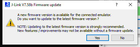

    [2022-Apr-13 10:44:53] [trace] [  JLink] - Firmware: J-Link OB-SAM3U128-V2-NordicSemi compiled Jul 24 2017 17:30:12
    [2022-Apr-13 10:44:53] [trace] [  JLink] - Updating firmware:  J-Link OB-SAM3U128-V2-NordicSemi compiled Feb  2 2021 16:47:20
    [2022-Apr-13 10:44:53] [trace] [  JLink] - Replacing firmware: J-Link OB-SAM3U128-V2-NordicSemi compiled Jul 24 2017 17:30:12
    [2022-Apr-13 10:45:38] [trace] [  JLink] -    ***** Error:
    [2022-Apr-13 10:45:38] [trace] [  JLink] - Communication timeout. Emulator did not re-enumerate.
    [2022-Apr-13 10:45:38] [trace] [  JLink] - Cannot connect to J-Link

    Here is the error log for the reference
  • Hi Leo
    Which version of the nRF52840DK do you have?
    Are you able to enter bootloader mode again?

  • Hi Sigurd,
    Thanks for your response!
    I am not sure where to find the version of the nRF52840DK. The sticker on the development board shows PCA10056      2.0.1      2021.10     683083855
    It still shows the same error after. I am not sure why Jlink keeps recognizing the firmware downloaded from https://devzone.nordicsemi.com/f/nordic-q-a/8144/i-can-t-update-the-j-link-ob-firmware-nrf51-dk is compiled in 2017.
    With the above being said, if I choose not to update the firmware in J-link commander, select no in the picture below.
    I am able to flash the program properly.
  • Sorry, the link in the above comment is not correct. The firmware I'm using is downloaded here, www.nordicsemi.com/.../J-Link-OB-SAM3U128-V2-NordicSemi-170724.bin
