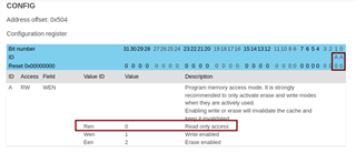

    (1)  Going back to my original question, I initially intended to protect the bit in register NVMC CONFIG by setting it to 0, i.e. 'Read only access'.
    If I do not consider protection from the debugger, am I correct in understanding that once the power is reconnected and reset after setting the NVMC CONFIG to 'Read only access', it will remain in 'Read only access' and cannot be written or erased?
    (2)  The programming of the bootloader is now too difficult for me and I don't know where and how to write the program. nRF5 SDK v17.1.0 has 'DFU bootloader examples' in the program examples, I am aware of it. However, for me, I don't need this much functionality and would prefer to have simple program examples that simply protect the flash memory.
    (1) Yes, the NVMC CONFIG register is always set to zero after reset as you can see from the register description here:
    (2) You can configure the ACL at the beginning of main() in your application if you don't plan to include a bootloader.
