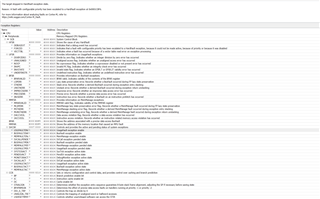

    Also for more context on the error I've started debugging with Ozone, this is the full error state that I'm still working through:
    The line throwing the error was in: ..\ncs\v1.8.0\zephyr\subsys\bluetooth\host\conn.c line 1152 which is:
    __ASSERT_NO_MSG(!k_is_in_isr());
    It has the associated comment:
         * PDU must not be allocated from ISR as we block with 'K_FOREVER'
         * during the allocation
    I wasn't sure what this meant, could you elaborate on what might be causing this error to throw.  ISR is the interrupt service routine but I'm not sure what PDR is or why my code might have caused this assert.  For testing purposes I commented out the line and the send worked properly but I want to solve the issue causing the error.
    PDU stands for protocol data unit, commonly known as packets. Looks like you can't call bt_nus_client_send() from the UART ISR. Instead, just put the UART data in a FIFO, e.g. with k_fifo_put(), and have a separate thread that sends the data. E.g. as done in peripheral_uart sample.
