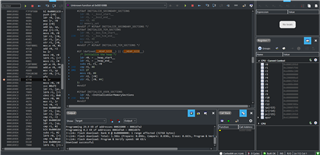

  • Hello, thanks for your answers, I have changed those things as you told me with the NRF_DRV_TIMER_INSTANCE now I have the last error that I don't understand  Could you help me fix this?
    thank you so much

  •  i can't see the app on the nrf connect app and I would to understant why and this is what i hvae when i'm debugging whenerver i'm clicnking the play button it stayed at the play and i put the photo :) thank you
    It is hard for me to say anything from the attached screenshot alone.
    Are you saying that the debugging session immediately stops when you try to resume it?
    If you do not enter into the debugging session, does the application behave as you would expect?
    If not, please elaborate and be as specific as possible on what behavior you are seeing, and how it is different from what you would have expected.
