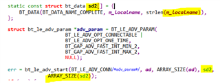

I received bt name via UART before call bt_enable(NULL);
but name information already defined at compile time.
static const struct bt_data sd[] = {
BT_DATA(BT_DATA_NAME_COMPLETE, DEVICE_NAME, DEVICE_NAME_LEN),
I found good option and API but it did not work.
CONFIG_BT_DEVICE_NAME_DYNAMIC
bt_set_name("new name")
When do I call bt_set_name() ?
Can you please guide for me?
