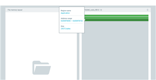

    I'm working on a bug that locks devices in MBR because of a corruption of internal flash.
    This seems to be from the hex file you put in nRF Connect programmer app. Could you post a screenshot from how it looks like when you read it from the flash?
    And the address range for the different regions?
    Some like this:
    (make sure to use the latest version of the programmer app)
    BR,
