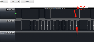

NCS 1.8 i2c can't get ACK (NACK), but old softdevices(SDK17) work well.
hardware: my test nrf52833 board
sensor:mpu6050 (I2C)

Question:
I use logic analyzer to trace, capture image like this, I can not get ACK.
But I use nrf52832(SDK17) can get ACK like this, so mpu6050 is OK.
