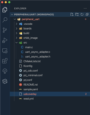

    So, when I complete the process, this is what my VS Code project looks like:
    And it builds without error, and I can flash it to my nRF5340 dk, step through code, see variables and memory space, etc. Alls great so far but notice in the image above, none of the zephyr or nRF Connect files are in the workspace. So where are they? One level up as you can see in this image:

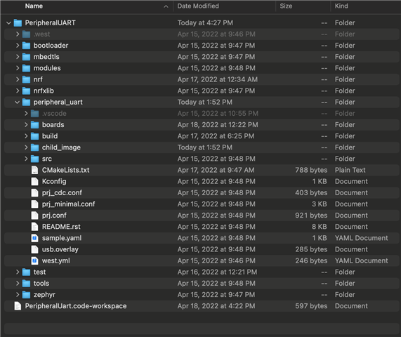

    1. Where do I initialize the git repo in this directory structure so when it is cloned, and west invoked, the entire project is replicated, which will build, flash, and run without error? Looking at the second image, should it be at the PeripheralUART level? Or the peripheral_uart level?
    2. What should the contents of the .gitignore be so only the necessary files are added and tracked in git? I know how to create the .gitignore, but in need to know, for the zephyr based project that uses west workspace, what should be ignored in addition to the build directory.
    A follow up question that has come up since my first post
    3. If changes are needed to the nRF SDK or zephyr files, how do those get included and tracked in git. For example, if NUS is used but the UUID needs to be changed how would that be done so change would be in the git commit? Would he whole SDK have to be added to the git repo?

    1) In this case it would be where the SDK is installed, I.E the root workspace folder PeripheralUART. If you initialize the git repo at periphehral_uart, it will only take the application project folder in a similar manner to what I suggested in my previous reply.
    Although this might seem like a optimal solution, I believe this will and may cause some possible time consuming issues down the line.
    One possible issue is that the SDK- and your project folder is over 4GB large, which will require quite a lot of files to both commit, pull and push whenever you're swapping devices or your colleagues clones the repository.
    A second issue I foresee is that you will spend some time to set the SDK up properly due to either some missing paths or that requirements such as nrfjprog has not been installed. The best way to guarantee this is to perform the SDK setup through either the toolchain manager in nRF Connect for Desktop, or through this manual installation guide. Both of these installation methods allows you to quickly swap between west workspaces or SDK versions if desired so after the installation procedure.
    2) This will be trickier. If you end up with going for your desired configuration where the SDK is a part of the git-repo, the only files I can guarantee that it would be ok to omit without diving deep into the SDK structure is the sample folders in zephyr and nrf. This will come with a drawback of having to look up the samples either online or in a separate NCS SDK workspace if you want to investigate how a sample such as central_uart sample works.
    3) The sample you are suggesting would not require you to change any of the files in SDK or Zephyr, but rather through configuring your application files either within prj.conf in the peripheral_uart folder above or by defined macros in the .c or .h files. All these files can be found within properly initialized application folder. But in case you modify a SDK or Zephyr file, the changes are handled by git! Git only tracks changes in your files, relative to the origin repository. So lets say you have a local repo on your computer that only has the UUID changed (1 code line) relative to the origin, the commit that will be pushed will only be that one line of code.
    To summarize, if I've understood your configuration properly, you will have to add the whole SDK to the git repo to get it to work as you describe. I would instead recommend you to install the SDK locally either through the automatic install in nRF Connect for Desktop or the manual installation guide linked above, and to only have your application in the repository. Every project I've worked on with NCS has used this "workspace philosophy", since what you want to change is on the application level of folders, and extremely rarely in the SDK files.

    Actually, I don't think you have understood this correctly. I suggest that you try creating a project from a sample as I have with the Nordic tools, specifically in VS Code with the nRF Connect Extension Pack. If you follow the steps I did, creating the project as a "Workspace" (not Freestanding) you will find that I did not "add the whole SDK to the git repo", but the nRF Connect VS Code plug-in (through the use of "west workspace") cloned all these additional git repos. As you can see in the following screenshot, the Nordic tool tells you the "west workspace" is used to manage the SDK version and it will create its own instance.
    This is not bad, it is actually good. The "west" pulls in the correct version of every thing needed to build the app. But, as you said, I do not want to add these to my git repo as it is unnecessary. I do not need a copy in my git repo because the "west" tool will pull in the correct version of the other git repos; that is its purpose.
    The guidance I need from your engineering team (please reach out to them for their guidance) is clear definition of what items need to be in my git repo so, when cloned and "west update" is executed, the west tool has the correct information to pull in everything else correctly.
    Again, these are the initial steps I did in VS Code (please, try it yourself):
    As I stated I’m used VSCode with the nRF Connect Extension Pack plugin. From the “nRF Connect for VS Code” welcome screen I selected “Create a new application from sample…”. In the next screen, for Application type I selected “Workspace”.
    If you try this and look in the director above your project you will see all the other repos were cloned as the workspace was created from the sample.

    This is what I based my previous answer on. If you investigate the folders from your workspace setup and compare it to the SDK installation folder from the automatic installation you will find that they contain the same files, e.g you clone the entire SDK with the exception of the west.yml file within your application folder.
    Yes, this is what "Application type workspace" does. It "sets up" the SDK in a new instance where you get your instance verified with the addition of a west.yml file that instances which version this application is for. In a freestanding this is not done and instancing and organizing where to put the application is left to the developer. You could compare the west.yml in peripheral_uart in your peripheralUART workspace and consult with the resources below if instancing the project fixes your issue.

    Without restating my previous reply here are some new suggestions and resources I recommend you try and/or read up on.
    • Brute force through deleting folders in the SDK, upload to git, clone back, pristine build and flash to see if it works. If it does not work, then there are some dependencies that causes you to require that folder.
    • Managing the code base should give you some tips and tricks if you want to work with git based development and how the SDK folders are related through git and west as well as more info about how to instance
    • NCS Structure and content as well as this older, but still valid NCS tutorial should tell you more about how the SDK is set and maybe give you more clues about the dependencies between the SDK folders.
