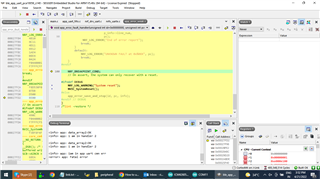

    Yes, i knew this concept but the thing is i want to send/ receive the data over BLE  so for this app_ble_uart example has been used just to send the command data to device to control the motor and at the same time the sensor data should be continuously send to device over HW UART so that's why i didn't change the uart_init() function only the TX,RX pins gets changed in my case as P1.3(TX), P1.4(RX) so then when i send command data to device it should receive over BLE and sensor data should be received over UART then why it showing me uart_communication_error .??
    so if its possible to do with single UART by  changing tx,rx pin numbers for HW UART then BLE should work separately as well as HW UART should work separately then why its giving me this error i don't know,
     while debugging i got this
    if BLE data and HW UART data received with the same same RX pin if i am not wrong is this a problem.
    please let me know your suggestion to implement this.
    thank you.
  • If you build the application in "debug" configuration (or add the DEBUG/DEBUG_NRF symbols to the projects preprocessor symbols), the log should output the error code and the location where the error occurred on the long, instead of just "Fatal error".
    My guess is that the application pass the error source from the communication error to the error handler, and the GPIO you set as RX pin is in the wrong state when you enable the UART RX, generating a FRAMING/BREAK error:
    If you have this APP_ERROR_CHECK in your application, please try to comment this out and see if it resolves the fatal error.
