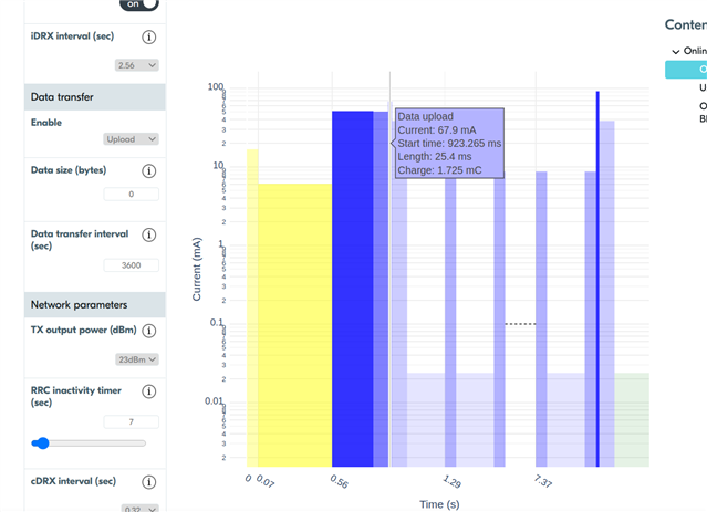

Why the time of uplink state is 950 ms if the data packet size is 0 Byte?
Can we say that every time a data is sent, it takes 950 ms
to get the transmission protocol?

That is strange, a 0 byte userdata payload should be alot faster to transfer than almost one second. Here's the timing that I got when I tried the same:
Maybe it did not refresh the former selection of bytes? Could you try refreshing the page and inputting 0 bytes upload again?

My question is in the mode NB-IoT not on LTE-M
Thanks for clarifying. Yes, I see the same.
This sounds a bit strange, even if NB1 is significantly slower than LTE-M, it should be quicker than this. I'll let the maintainer of the power calculator know about this, and we'll have a look.
