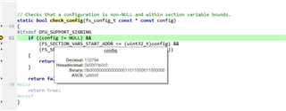

  • Can you set a breakpoint in check_config() in fstorage.c and check the value of config and the FS_SECTION_VARS_START_ADDR and FS_SECTION_VARS_END_ADDR macros?
  • Sure Bjorn.
    The value of config is 110784 (decimal format). i am not able to find the values of other two macros, its just displaying both the conditions as true and returning false.
    Attaching the screenshot of the debug log for your reference.
