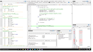

  • Thanks for the screenshots.
    In the disassembly I can see that the FS_SECTION_VARS_START_ADDR, which is loaded into r3 is 0x20005010 (  __fs_data_run_start__) and that FS_SECTION_VARS_END_ADDR is 0x20005430 ( __fs_data_run_load_end__). The config variable is 0x0001b0c0, which is flash and not RAM.
    The fs_dfu_config variable of type fs_config_t should be a static and should be placed in RAM, not flash.
     You need change
     <ProgramSection alignment="4" load="Yes" name=".fs_data" />
    under FLASH MemorySegment to the following to ensure that in runs in RAM
      <ProgramSection alignment="4" keep="Yes" load="Yes" name=".fs_data"  inputsections="*(.fs_data*)" runin=".fs_data_run"/>
    I also see that you have two sections with name fs_data_run in the RAM memory Segments
    <ProgramSection alignment="4" size="__STACKSIZE__" load="No" name=".fs_data_run" address_symbol="__start_fs_data" end_symbol="__stop_fs_data" />
    <ProgramSection alignment="4" keep="Yes" load="No" name=".fs_data_run" address_symbol="__start_fs_data" end_symbol="__stop_fs_data" />
    Can you try to remove the first one?
    -Bjørn
  • Thanks for the quick reply Bjorn.
    I made all the changes you have mentioned and debugged. This time it is giving FDS_ERR_NO_PAGES in the pages_init function.
    i am attaching the screenshot of the debug trace for your reference.
    Waiting for your quick reply.
    Best,
    Krish
