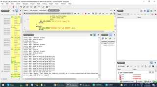

  • Hello Edvin,
    thanks for reply, i gone through the uart_init() present in the app_ble_uart  example and in app_uart_fifo.c  i have duplicate the app_uart_init() and how can i pass the APP_UART_DRIVER_INSTANCE 1 to this i am get confused that  how it will take the UARTE to the app_uart_init() . i hope you get my problem that i have explained from the top. in uart_init() i changed the TX,RX pins to P1.3,P1.4 so if i send the data(commands) from my customized APP to the device and its receiving properly and at the same time if i am trying to send the data from the MAX232 which is connected to the  same P1.3, P1.4 (TX,RX) of MCU so that's why its going to break condition in the uart_handler so for this can we use two UART's.
    if yes, please guide me that in app_uart_fifo.c how can add another app_uart_init() .??
    thank you.
