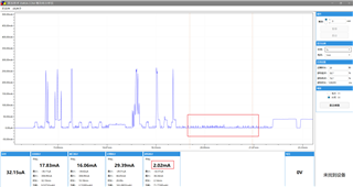

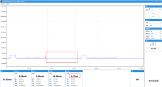

case about NRF9160 High registered network current (test environment, no NB network signal)
1. Please solve the problem of high network current registered to nRF9160 (test environment: no network signal)
2. Rf signal: the test current is normal. See Appendix A for the test data
3. No RF signal (shielded room) : the test current is abnormal. See appendix B for the test data
4. Tools for opening test data: see Attachment: C
5. See Attachment D for test example

6. Test DK: PCA10090 0.9.0 2019.21
7. Test SDK: NCS V1.9.1

  • Modem team commented;
    Log analyzed. I did not have description for test case execution, but I tried to open the situation below. There are three modem activation with AT+CFUN=1, in first two of these cases LTE NW was present and modem was able to attach and register to NW.
    Third modem activation with AT+CFUN=1 was not able to find network. There were no band limitation (AT%XBANDLOCK) set, so modem searches lots of bands and frequencies and it can take time, minutes. Most likely that search pattern is visible in current consumption graph.
    This search time can be optimized for test purposes and also for products by using for example AT%XBANDLOCK and AT%PERIODICSEARCHCONF. There are also other good AT commands for optimizations like AT%XCOUNTRYDATA, AT%MDMEV and AT%XMODEMSLEEP.

    09:50:57.618643 +CFUN=1
    Search starts here and continues..
  • Hi Hakon,
    The above method is proved to be effective
