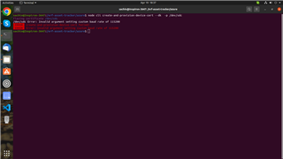

Generate and provision the device certificate
I use this code " node cli create-and-provision-device-cert"
But I am using nrf9160 ,so therefore I change this code to "node cli create-and-provision-device-cert --dk "
Now to change the default port to /dev/sdc ,I run command  "node cli create-and-provision-device-cert --dk  -p /dev/sdc"
It showing error of "Error: Invalid argument setting custom baud rate of 115200"
Help me to change the port, and change all default value from thingy91 to  nrf9160
    Are you trying to program an nRF9160 DK? Can you please run --debug as well
    node cli create-and-provision-device-cert --dk --debug
    Øyvind
  • Yes I am programming nRF9160 DK
    I have run --debug and it shows error
  • Please provide full log, not screenshot, from where you called the command.

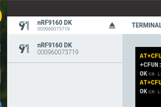

    What version of the nRF9160 DK are you using?
    Our Asset Tracker developers are currently out of office, which means that I do not have an answer before Monday I'm afraid.

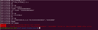

  • This is full log,Sorry I can't be able to take screenshot so I copy paste it
    sachin@Inspiron-3647:/nrf-asset-tracker/azure$ node cli create-and-provision-device-cert --dk --debug
    Flasing certificate /dev/ttyACM0
    Connecting to /dev/ttyACM0
    Inactivity timeout 10 seconds
    /dev/ttyACM0 connected
    AT Host h
    w4 4001e504 2
    w4 4001e50c 1
    sleep 100
    rx 1000
    h
    w4 4001e504 1
    loadfile /nrf-asset-tracker/azure/node_modules/@nordicsemiconductor/firmware-ci-device-helpers/at_host/91dk_at_host_increased_buf.hex
    rx 1000
    g
    exit

    /dev/ttyACM0 *** Booting Zephyr OS build v2.7.0-ncs1 ***
    /dev/ttyACM0 Flash regions Domain Permissions
    /dev/ttyACM0 00 01 0x00000 0x10000 Secure rwxl
    /dev/ttyACM0 02 31 0x10000 0x100000 Non-Secure rwxl
    /dev/ttyACM0 Non-secure callable region 0 placed in flash region 1 with size 32.
    /dev/ttyACM0 SRAM region Domain Permissions
    /dev/ttyACM0 00 07 0x00000 0x10000 Secure rwxl
    /dev/ttyACM0 08 31 0x10000 0x40000 Non-Secure rwxl
    /dev/ttyACM0 Peripheral Domain Status
    /dev/ttyACM0 00 NRF_P0 Non-Secure OK
    /dev/ttyACM0 01 NRF_CLOCK Non-Secure OK
    /dev/ttyACM0 02 NRF_RTC0 Non-Secure OK
    /dev/ttyACM0 03 NRF_RTC1 Non-Secure OK
    /dev/ttyACM0 04 NRF_NVMC Non-Secure OK
    /dev/ttyACM0 05 NRF_UARTE1 Non-Secure OK
    /dev/ttyACM0 06 NRF_UARTE2 Secure SKIP
    /dev/ttyACM0 07 NRF_TWIM2 Non-Secure OK
    /dev/ttyACM0 08 NRF_SPIM3 Non-Secure OK
    /dev/ttyACM0 09 NRF_TIMER0 Non-Secure OK
    /dev/ttyACM0 10 NRF_TIMER1 Non-Secure OK
    /dev/ttyACM0 11 NRF_TIMER2 Non-Secure OK
    /dev/ttyACM0 12 NRF_SAADC Non-Secure OK
    /dev/ttyACM0 13 NRF_PWM0 Non-Secure OK
    /dev/ttyACM0 14 NRF_PWM1 Non-Secure OK
    /dev/ttyACM0 15 NRF_PWM2 Non-Secure OK
    /dev/ttyACM0 16 NRF_PWM3 Non-Secure OK
    /dev/ttyACM0 17 NRF_WDT Non-Secure OK
    /dev/ttyACM0 18 NRF_IPC Non-Secure OK
    /dev/ttyACM0 19 NRF_VMC Non-Secure OK
    /dev/ttyACM0 20 NRF_FPU Non-Secure OK
    /dev/ttyACM0 21 NRF_EGU0 Non-Secure OK
    /dev/ttyACM0 22 NRF_EGU1 Non-Secure OK
    /dev/ttyACM0 23 NRF_EGU2 Non-Secure OK
    /dev/ttyACM0 24 NRF_EGU3 Non-Secure OK
    /dev/ttyACM0 25 NRF_EGU4 Non-Secure OK
    /dev/ttyACM0 26 NRF_EGU5 Non-Secure OK
    /dev/ttyACM0 27 NRF_DPPIC Non-Secure OK
    /dev/ttyACM0 28 NRF_REGULATORS Non-Secure OK
    /dev/ttyACM0 29 NRF_PDM Non-Secure OK
    /dev/ttyACM0 30 NRF_I2S Non-Secure OK
    /dev/ttyACM0 31 NRF_GPIOTE1 Non-Secure OK
    /dev/ttyACM0 SPM: NS image at 0x10000
    /dev/ttyACM0 SPM: NS MSP at 0x200185f0
    /dev/ttyACM0 SPM: NS reset vector at 0x11ff5
    /dev/ttyACM0 SPM: prepare to jump to Non-Secure image.
    /dev/ttyACM0 The AT host sample started
    /dev/ttyACM0 AT> AT+CGSN=1
    /dev/ttyACM0 +CGSN: "352656106650834"
    /dev/ttyACM0 <AT +CGSN: "352656106650834"
    /dev/ttyACM0 OK
    /dev/ttyACM0 <AT OK
    IMEI: 352656106650834
    /dev/ttyACM0 AT> AT+CGMR
    /dev/ttyACM0 mfw_nrf9160_1.3.1
    /dev/ttyACM0 <AT mfw_nrf9160_1.3.1
    /dev/ttyACM0 OK
    /dev/ttyACM0 <AT OK
    /dev/ttyACM0 OK
    /dev/ttyACM0 <AT OK
    /dev/ttyACM0 AT> AT+CFUN=4
    /dev/ttyACM0 OK
    /dev/ttyACM0 <AT OK
    /dev/ttyACM0 AT> AT%KEYGEN=42,2,0,"CN=352656106650834","101010000"
    /dev/ttyACM0 ERROR
    /dev/ttyACM0 <AT ERROR
    ERROR create-and-provision-device-cert failed!
    ERROR AT command AT%KEYGEN=42,2,0,"CN=352656106650834","101010000" failed on /dev/ttyACM0: ERROR after write.
