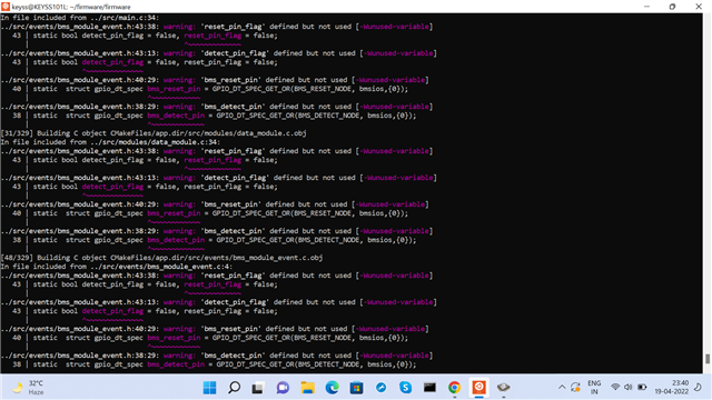

Defined but not used warning
I added some functionality to asset_tracker_v2. I used two pins of Nordic chip for following purpose: 1. Detect BMS, pin as Input 2. Reset BMS, pin as output. The pins overlay is added in nrf9160dk_nrf9160_ns.overlay file. The pins configuration and binding etc is done in an bms_module_event.h file. The pins are handled in a thread function in bms_module.c file a below:

The below mentioned content is from bms_module_event.h file :
static bool detect_pin_flag = false, reset_pin_flag = false;
#define BMS_DETECT_NODE DT_ALIAS(bmsdetect)
#define BMS_RESET_NODE DT_ALIAS(bmsreset)
#if !DT_NODE_HAS_STATUS(BMS_DETECT_NODE, okay)
#error "Unsupported board: BMS_DETECT devicetree alias is not defined"
#if !DT_NODE_HAS_STATUS(BMS_RESET_NODE, okay)
#error "Unsupported board: BMS_RESET devicetree alias is not defined"
static struct gpio_dt_spec bms_detect_pin = GPIO_DT_SPEC_GET_OR(BMS_DETECT_NODE, bmsios,{0});
static struct gpio_dt_spec bms_reset_pin = GPIO_DT_SPEC_GET_OR(BMS_RESET_NODE, bmsios,{0});
The code added to overlay file is below:
aliases{
bmsdetect = &bmsdetect;
bmsreset = &bmsreset;
bmspins {
compatible = "bmspins";
status = "okay";
bmsdetect: bms_det {
bmsios = < &gpio0 0x8 0x11 >;
label = "BMS Detect PIN";
status = "okay";
bmsreset: bms_rst {
bmsios = < &gpio0 0x9 0x11 >;
label = "BMS Reset PIN";
status = "okay";
Though build is successful, but shows warnings as shown in image below. Why these warnings and what is the solution ?
