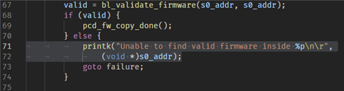

    I am working through a problem similar to yours. Regardless of whether I use mcumgr or the nRF Connect app, performing a DFU that includes net_core_app_update.bin causes my firmware to enter a boot loop. After much poking around, I found that b0n (netboot) fails here:
    It looks to me like fw_info_find was returning NULL, indicating that it did not find the fw_info block in the uploaded image. I can see a FW_INFO magic number at offset 0x400 in the net_core_app_update.bin file. I will confirm that the magic number in the .bin file matches the one that b0n is looking for.
  • More progress - the fw_src_address passed to bl_validate_firmware is 0x0000be0b. It gets this address from the PCD data supplied by MCUBoot. MCUBoot assumes that b0n knows that this address points to the external flash, but fw_info_bare dereferences the address like a regular pointer. So, instead of reading the external flash, b0n is reading junk.
    Seems to me like Nordic's code would work fine for setups where both slots are kept on internal flash, but if your secondary slot is in external flash, b0n will fail.
