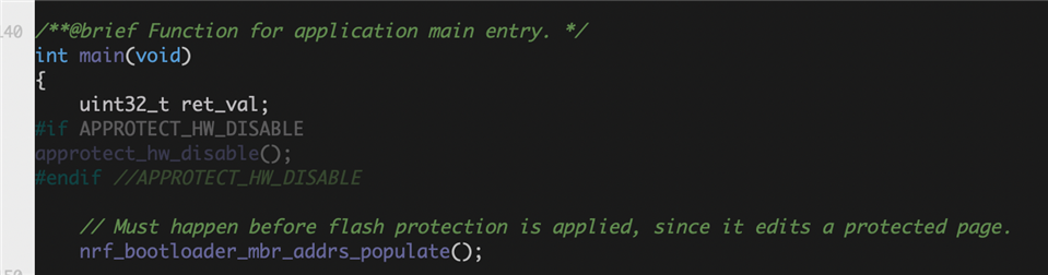

I am using an nRF52840 DK board that I just bought, but have ran into a weird issue that I have never come across when using our old nRF52840 DK. I have a script that I use to first compile my project code, and then flash everything onto my DK board. Here is the code of that script:

My code compiles and the hex files are generated as a result of the calls to make -C "$boot_make" and make -C "$app_make". However, when the script finishes programming the softdevice, it complains with ERRORS about the other .hex files I am trying to flash. Here is that output for your reference:
Only moments ago, when running the same code for an older DK (same nRF52840), this script worked fine and everything flashed correctly. I cant figure out why this new DK board causes the programming to fail. What might be causing this new behavior (even though there is no code change)?
I have also attached the log output file from logging the first failing nrfjprog --program command for your reference....if it helps.
The only other thing I have tried is to erase my device from Segger ES (Target > Connect JLink, Target > Erase All), download the secure bootloader ble example, then download my custom application. When I Build and Debug this code, my project always fails at this function, with the same error (NRF ERROR NO MEM "No bootloader found"):
APP_ERROR_CHECK(ble_dfu_buttonless_async_svci_init());
    Seem you are programming s132_nrf52_7.0.1_softdevice.hex and nrf52832_xxaa_s132.hex to nRF52840DK. For nRF52840, you use --family NRF52840 to generate the setting.
    To use the new version of nRF52840DK, you have to run "nrfjprog --recover" to disable the approtect. See this blog.
    Amanda
  • That makes complete sense, thanks. Do you know why our previous nRF52840 DK is able to run this nRF52832 code without ERROR? I feel like I would have been able to encounter/resolve this bug much sooner if the first DK board worked in the same way as this new one...Im curious to hear your thoughts.
    Also, I did what you suggested. I made sure to refer to the correct s140 SoftDevice for the nRF52840. The softdevice flashes perfectly to the DK board, as before. I am simplifying my script for step-by-step debugging, and all I try to do after flashing the softdevice is to flash the bootloader. I made edits to the script to also reference the correct bootloader, as you can see here:

    Unfortunately, these new changes dont seem to help. I am still encountering the same ERROR from the nrfjprog command line tool, which you can see here:
    Lastly, I have included the log output from this failed flash for your reference. What could be causing this error? What should I try to debug this issue? Thank you so much for your help with this.

    cor10 said:
    Are you suggesting I edit this file and remove the if-case that checks to see if defined(ENABLE_APPROTECT)? This way APPROTECT will never be used, is that correct?
    No, I suggest you add the disable function to the secure_bootloader as that post.

  • Ok, now I understand what you mean about that post you linked. When I clicked it at first, I went to the selected/verified solution of the post, which mentioned downloading the newest MDK version and so I tried that. The disable function you are referring to did not solve the problem for the person who made the post, so I overlooked that.
    Now that I understand, I added the disable function to my secure_bootloader solution in the main.c file at the beginning of the main() function, exactly as is suggested in the post you linked (I didnt use your .hex file because I have necessary configs set in the sdk_config.h file). However, this solution does not work for me. I notice that the #if statement appears inactive in my SEGGER IDE, so perhaps it is never run:
    Also, let me show you the series of commands I make from my terminal so you can see my situation more clearly:

    Regardless of these efforts, I was able to find a (hacky) solution!!! If I write 0x5A to the APPROTECT.DISABLE register (0x40000558), I am able to access the DK device even after running the 'nrfjprog --reset' command. I also make sure that the value of UICR.APPROTECT register (0x10001208) is 0x5A.
    % nrfjprog --memrd 0x10001208
    0x10001208: 0000005A                              |Z...|
    % nrfjprog --memrd 0x40000558
    0x40000558: 00000000                              |....|
    % nrfjprog --memwr 0x40000558 --val 0x5a
    Parsing parameters.
    Writing.
    0x40000558: 0000005A                              |Z...|

    So, I can now successfully connect to the SEGGER IDE for debugging and my code is finally running! HOWEVER, with this solution, I notice that whenever my DK device is powered OFF and then back ON again, the DK goes back into the APPROTECT state and locks me out. So if I turn my device OFF, I can no longer connect to the SEGGER IDE for debugging, and I have to recover the device and run my programming script again. Even though I do not re-write to the APPROTECT.DISABLE register, I notice that the value is still 0x5A after erasing everything and re-programming. Do you know why this happens when the device is turned OFF? Is there a way I can avoid this behavior after power OFF? Or is there a more elegant solution?
    Thank you :)
    You can add "APPROTECT_HW_DISABLE" to Project -> Preprocessor -> Processor Definitions to enable the tag. Once programming the bootloader with  APPROTECT_HW_DISABLE, it will write the
    Not sure why caused that.
    What is the value of 0x10001208 after powered OFF and ON? Guess the value at UICR.APPROTECT register is written by your image. It should use the bootloader with APPROTECT_HW_DISABLE that can write  UICR.APPROTECT register (0x10001208) to 0x5A.
    -Amanda
  • Amanda, thank you for sticking with me through this battle. With that Preprocessor Definition, the approtect_hw_disable() #if-statement runs properly and allows access to the debugger every time now.
    Also, I figure that the value of the APPROTECT.DISABLE register seems to be RESET to 0x0 after a power OFF/ON, which is why I was seeing the APPROTECT come up again. But now with the new working secure_bootloader, the device disables APPROTECT functionality even after being turned OFF/ON.
    Thank you, I have learned a lot!
    Cheers,
    Corten
