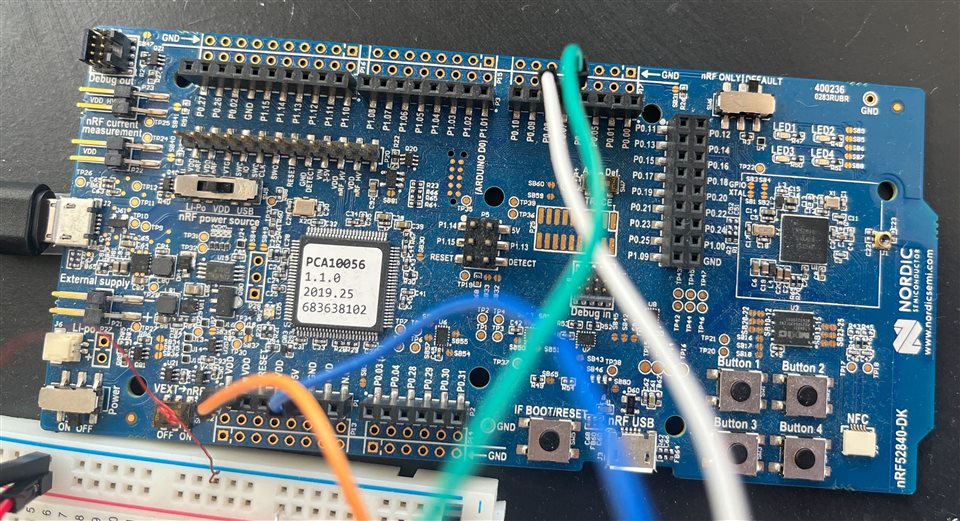

    On the older DK board, here is what the sticker says:
    • PCA10056
    • 1.1.0
    • 2019.25
    • 683638102

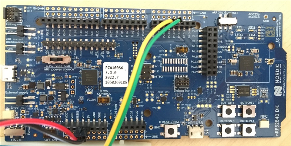

    On my most recent DK board:
    • PCA10056
    • 3.0.0
    • 2022.7
    • 1050260108
