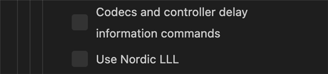

I have spoken with the Zephyr support team and they say that that error is a controller error. So I would like to change from Nordic SoftDevice controller to the Zephyr controller by making the following changes in Kconfig:
1. Enabled Bluetooth controller. Software-based BLE link layer was auto selected.
2. Enabled extended advertising
3. De-selected 'Use Nordic LLL'
Saved changes to prj.conf which now looks like this:
