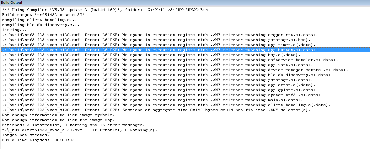

BLE_DB_DISCOVERY_MAX_CHAR_PER_SRV Issue
image descriptionI'm trying to discover a vendor specific service that has 7 characteristics. However, when I increase BLE_DB_DISCOVERY_MAX_CHAR_PER_SRV to 7 , ble_stack_init() hard faults on SOFTDEVICE_HANDLER_INIT(NRF_CLOCK_LFCLKSRC_XTAL_20_PPM, false);
I'm using SDK 7.2
