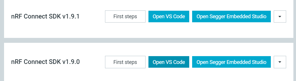

 I dwnload the nrf connect for desktop in my pc.i want to use the VS extension foe NRF.But i have had NCS 1.9.0 and 1.9.1 .The SDK of NCS  is from my baidu pan.so i only install the VS  for nrf extension.I remember that i only download the some extension such as nRF Kcnofig so on.

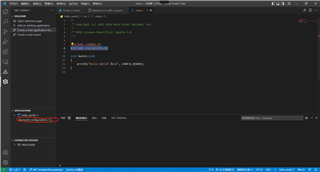

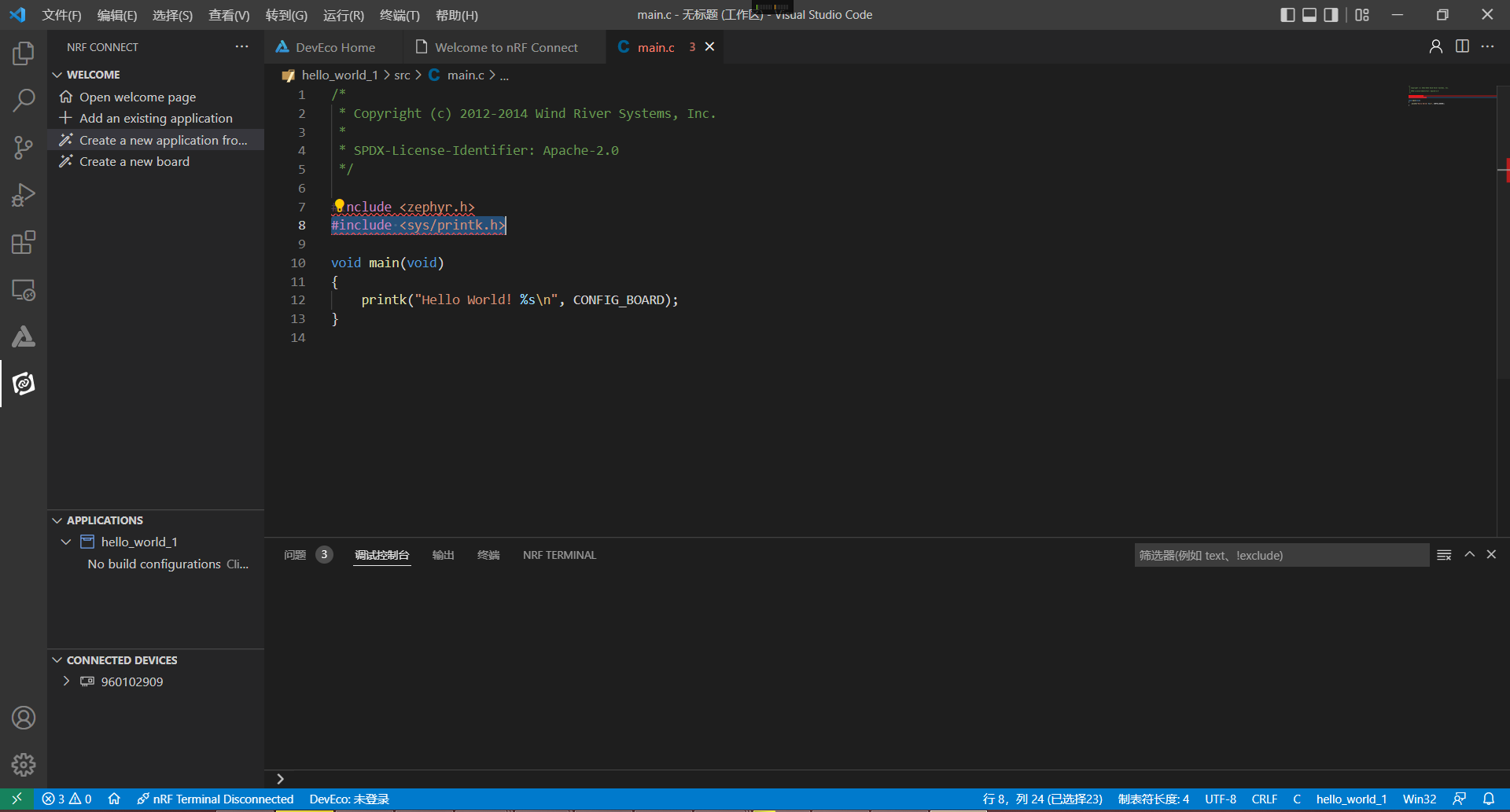

then i make a new project in this folder.but it seem to be failed.three no  other error.i am strangte that there is no complie for my blinky project .

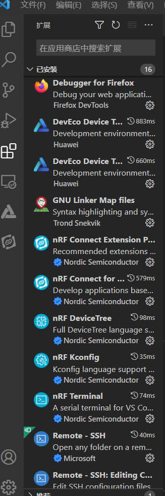

the next  is my nrf  plug-in.it is full.
The NCS is in C.The NCS I have are two version.one is 1.9.0,another is 1.9.1..they are in C:\NCS
I find that the NRF seem less than what  you have in vidieo.they are in this picture.

    It does not look like have made a board configuration yet, and then you are also not able to compile. You should first add a build configuration, starting by clicking on the part I have highlighted below (in your screenshot):
    After that, you will also bet options to build on the nRF Connect menu on the left side. There are some good getting started videos. If those are not easily accessible you can for instance refer to this good post about how to use it.
